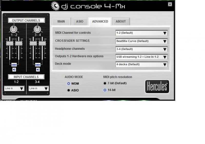

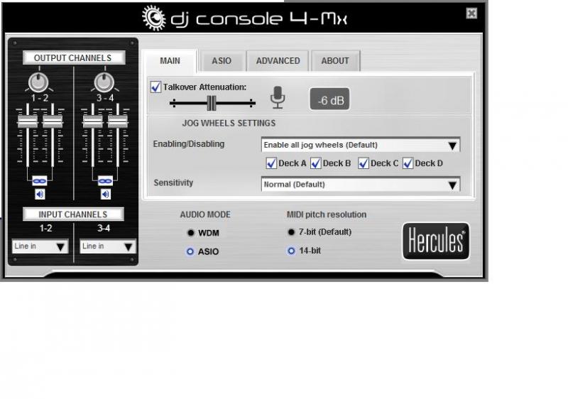

When I configure the 4-Mix as seen in image the control panel in Hercules automatically switches from WDM to ASIO, I also tried the Mic setting in place of "Line 1&2" and got the same results?

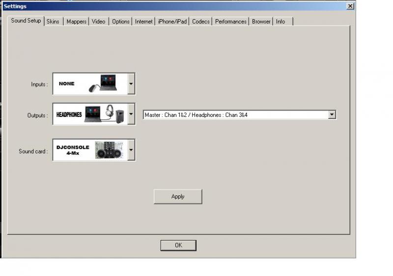

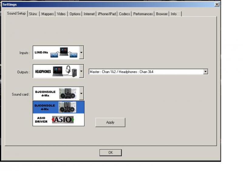

Okay, I managed to get the Hercules control panel to stay on WDM sound drivers when using VDJ, I found this to work using these setting on VDJ and Hercules control Panel, would like to use my lines on the controller, but this seems to flip the panel into ASIO...
