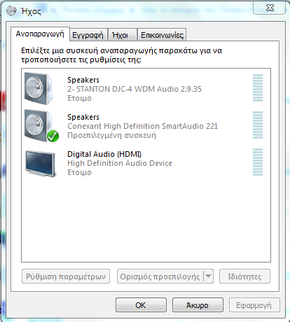

\\\"\\\"If you are using a MIDI controller that has a built-in sound card or you are using an external DJ sound card (E.g: Numark DJIO), then Windows may also be trying to use it as its default playback device, which in some cases may cause a conflict. Make sure that Windows is set to use your computer\\\'s own built-in sound card as its default device (Start -> Control Panel -> Sound -> Manage audio devices\\\"\\\"
Με βα ση τα παραπανω ποια απ τις δυο ρυθμισεις ειναι η σωστη?
geposted Sat 26 Oct 13 @ 8:00 am
H prwti rythmisi einai i swsti, an kai otan xrisimopoieitai to ASIO, oi WDM drivers den xrisimopoiountai, entoutois kalou kakou.. kane tin prwti rythmisi (dld min exeis tin Stanton proepilegmeni karta ixou)
Btw, kalo tha einai na ksanaelekseis tis rythmiseis toy ypologisti sou oson afora to performance. Apo oti vlepw exeis ta Aero energopoiimena.
Ti leitourgiko exeis ?
geposted Sat 26 Oct 13 @ 10:00 pm
Eκανα τις αλλαγες συμφωνα με το link που μου εστειλε ο djdad(κι οχι μονο) και μεχρι στιγμης ολα δειχνουν να δουλευουν ρολοι.Στο DPC Latency Checker ολες οι οι μπαρες ειναι στα πρασινα καθολη τη διαρκεια των gigs. Thanks guys!
