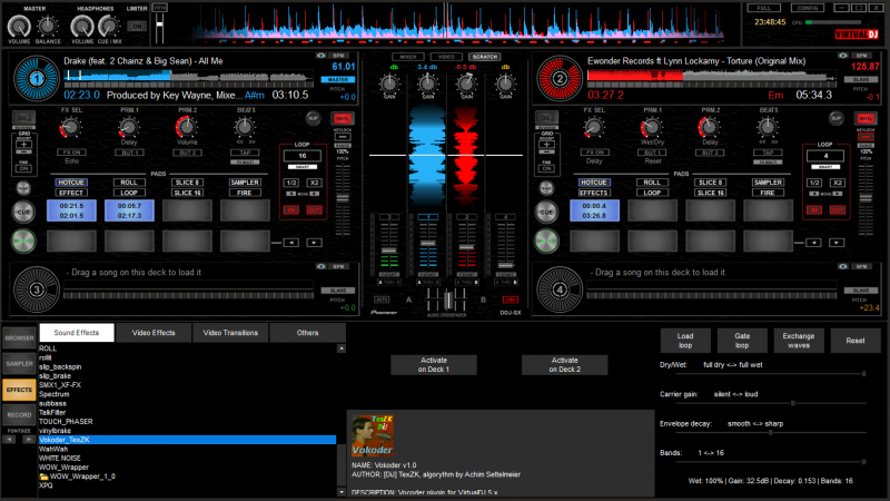

Is the effect name correct? that's not vocoder unless your from Europe... I think Tex_ZK is spanish
geposted Sun 27 Oct 13 @ 11:32 pm
This is what I have.
