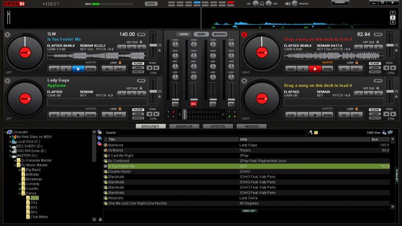

I had no PFL/ Cue listening. I had the sound setup as a the main laptop out so I did not have a monitor/ PFL/ Cue way of listening... Hope that helps. The image sows what happens with the swap....
As you can see from the image in Deck 1 it shows the title of Deck 2 which is 3lw - Is You Feelin' Me and loaded into Deck 1 is Lady GaGa - Applause however the info shows up in Deck 3. How to do I correct this???
geposted Sun 17 Nov 13 @ 10:54 am
I just opened up the default 1920x1080 4 deck skin, it actually already has a panel for a 1234 layout... I couldn't find the button on the skin to switch it but you can add it to your controllers ONINIT:
skin_panel 'mixer1' on
or you can add it to you skin xml with the following line, **paste it at the end just before the closing </skin> tag "eg line 4127 of the 1080 skin".
<init action="skin_panel 'mixer1' on" />
If you have a backup of the original file before you modified it use that, otherwise put your skin file in the webpage and press the button two more times "I would give it about a second to finish before pressing it the second time, don't just mash it twice because there is no way to restore it if it messes up, you would have to download it again."

I found the skin however. I have lost all audio output unless I go to basic audio output....
geposted Sun 17 Nov 13 @ 12:37 pm
the only other thing I can think of is change the routing of the mixer with the advanced sound config. with that you can add all your decks and choose the output channel
config -> sound setup -> output -> advanced config;
