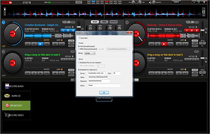

Here is a snapshot of the config that they claim is correct and should work.
that setting is wrong.
You put the "mount point" in the name field in broadcast settings.. It should not be there. Rather put your DJ name there.
The mount point goes into the SERVER field, after url.
Server: broadcast.mixify.com/23423423xx.ogg
And even if you can connect with other test software, you might still have VDJ blocked in your firewall.
Double check that VDJ can actually connect to internet
geposted Fri 13 Dec 13 @ 8:12 am
You were correct. Once I added the mount point to the server field I was able to broadcast.
