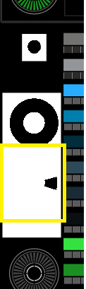

Open the bmp file of the skin with a Graphics software (Photoshop, PhotoPaint, or what ever you use..even Paint may do the job)
You will have to rotate the yellow part 90 degrees anti-clockwise. (for both Battle and Full files)
It wont be easy though, as you need to be quite accurate and find the exact center point of the sector circle, but the full circle above may help you to align that again.

Well thats not what I expected, but I'll give it a try. Thanks I really appreciate the help and once again great skin
