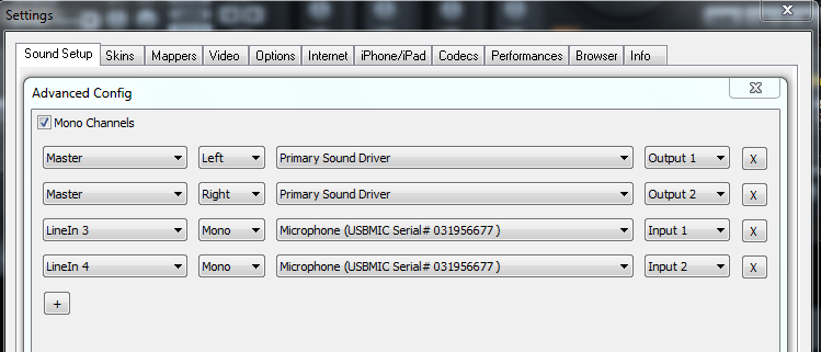

okay, my curiosity is satisfied..
got this all back out again and did this..
The device in this test is the PS2 singstar. BUT between mic and my headphones there is nearly 1 second of lag.
Has anyone here tryed all this but with an ASIO soundcard?
I only have the Audio 2 DJ ASIO, but it only has 2 outputs and no inputs..
I have more soundcards around with line-in which i haven't tried yet (with maybe ASIO for all)
What are your experiences??
