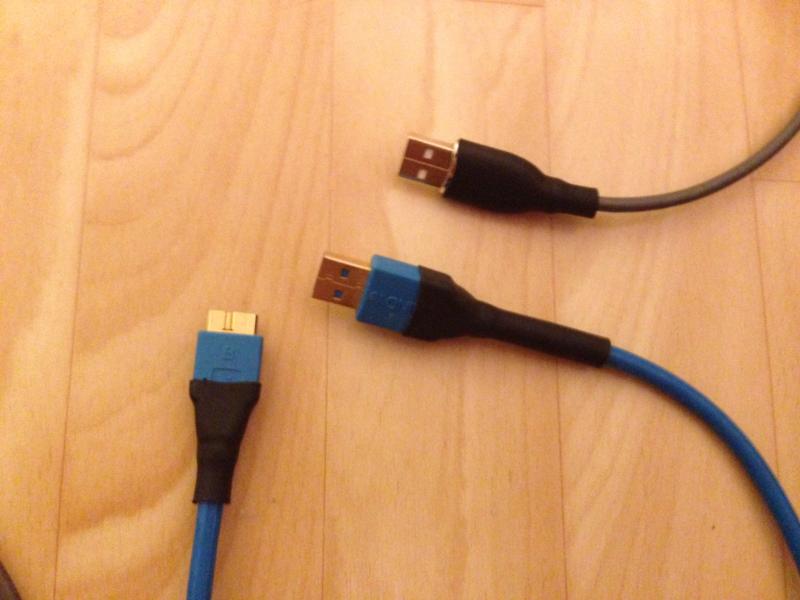

I tend to get the right lengths I need, i.e. 0.5m, 1m etc and heat shrink the ends.
18mm 3:1 is what I use but if you can get 18mm 4:1 even better, do not get adhesive/glue heatshrink.

These are USB conductor digital audio cables right? I like how you protect the connector part with the tape.

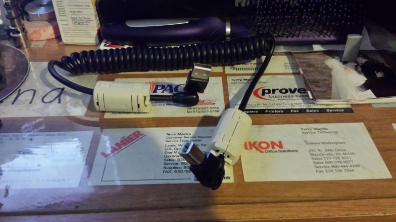

I use some of these. They pivot 360 degrees at both ends. I purchased four of them. I haven't been able to find them in a couple of years now though. I also put on ferrite cores, to reduce signal hum from nearby electronics.

Lol, thats heat shrink.
