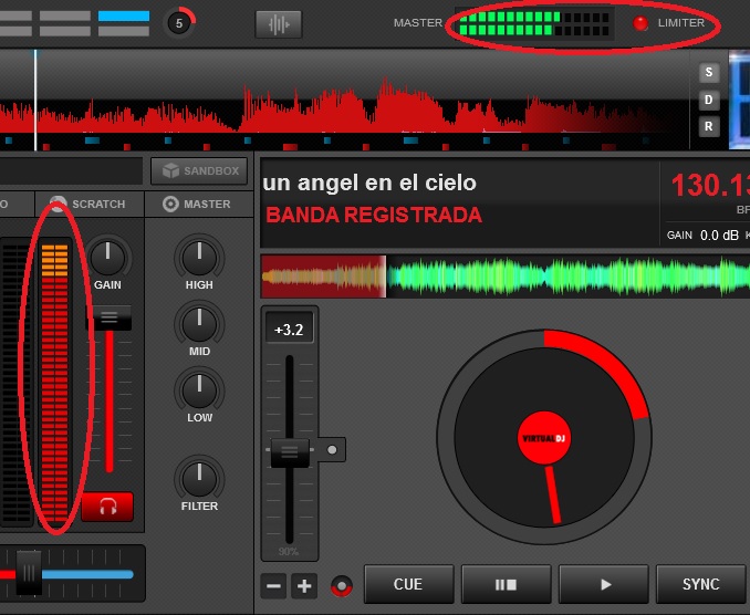

scrach work, saturates the master channel ...
.jpg)
geposted Mon 09 Jun 14 @ 5:53 am
Of course it does if you leave the bass in.
geposted Mon 09 Jun 14 @ 6:28 am
Actually he does have a point.
Compared to VDJ 7 there seems to be a huge increase in output level when scratching.
I've just tried it with Get Lucky. In 7 I can scratch away frantically and the deck meters are still 2-3 bars away from the top. Do the same test in VDJ 8 and the deck levels shoot right up to the top, and the limiter kicks in.
geposted Mon 09 Jun 14 @ 6:36 am
