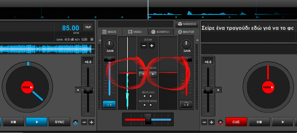

kalispera pedia kai xronia polla , ithela na rotiso ksafnika exasa tis grames den kserw pos alios na to eksigiso sas stelno mia foto na katalavete :P lol
geposted Thu 15 Jan 15 @ 3:30 pm
hmm auto mporei na ofeiletai se poly mikro resize tou skin. Des an kata lathos allakses tin analysi tis othonis sou se kati mikrotero apo tin megisti (default)
