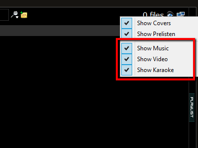

Ensure you have these options selected, click the "eye" button:

I click the eys and it opens into a large screen. I tried right clicking too and all I get is cover and something else. (Im not in front of puter right now)

Left click eye and show covers and show prelisten come up. Nothing else. I right click and the same thing.

What I did do is do a "reset to factory settings". That worked. Now, I still wonder what someone did. I know in the past if that happened I clicked on the eye or whatever it was in previous versions and saw that the karaoke and or the video selections were not selected and that worked however this time around nothing showed up but the first two selections. Someone must have messed up something unbeknownst to the gurus. I'm glad that reset option is there. Worked fine after that.
