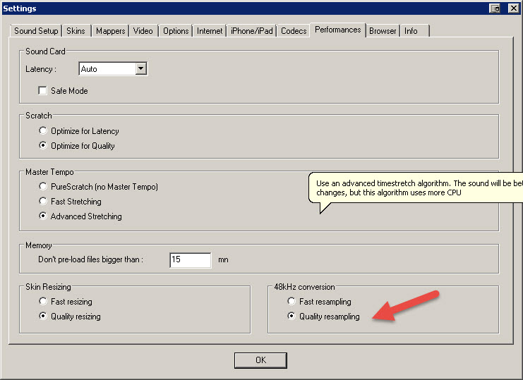

OK so after messing around for hours I think I finally got it.
On the Rane ASIO Driver there is an AUDIO BUFFER which I had to set to 25...by default its set to 8
and then in the Config for VirtualDJ this setting made all the difference
Could this be because the Soundcard is running at 48K and is having to convert everything from 48k back down to 44.1?
With this on I am able to have KEY LOCK on and pitch a song all the way up or down by 30% without hearing any artifacts in the sound. As soon as I turn this off it sounds terrible. Like the sound is getting squashed.
