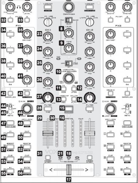

This is mmy mixer locodog i been try to get at synthetic but i d o need some mapping help and advice.
Like knob 46 i want it to shorten and lengthen the loop right now when i turn it either way it shortens i want a clockwise turn to lengthen and counter-clockwise to shorten the loop
geposted Tue 10 Jun 14 @ 8:32 pm
Believe it's something like,
Param_greater 50% ? Loop_select -1 : loop_select +1
Don't have my mixer out and I'm doing this on my phone but that should be a start I think.
