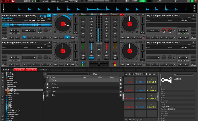

It would be possible in the default skin but you would have to do some serious modifications.
As RobRoy says there are some skins to offer more custom buttons. The one shown above is Altern8 (I think).

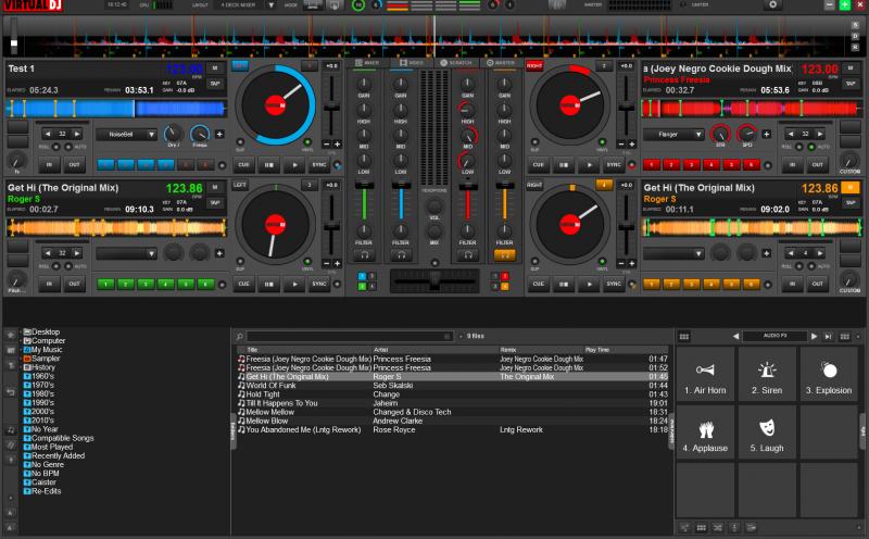

Ok so some progress has been made as per the pic
I managed to create some space for some custom buttons (between Deck 3 & 4 and the Browser)
I'm thinking if I simply copy a group from the XML code, rename it and position it in the space created it should work ?? is that viable or is there a better way to do it.

Do you need all 6 hot cues? if not take 3 from each of the bottoms decks and change to xml this way you dont have to add any button
geposted Fri 13 Jun 14 @ 8:19 pm
Yes, that exactly what you need to do.

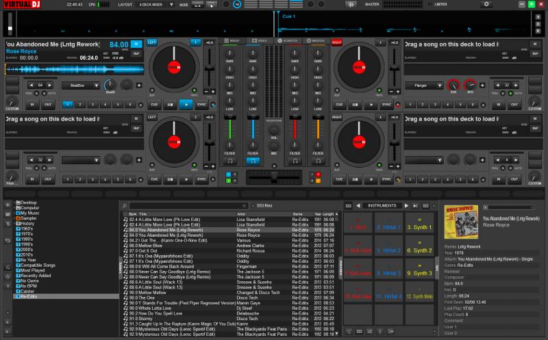

Ok so just an update on this project - I finally managed to work things out by trial and error but in the main with a lot of help from they guys on here, Robroy, DJdad, GroovinDJ amongst others - thank you all so much.
What I ended up with is shown below but the gist of what I've done is:-
Increased the Font size on the cue point information and move the text lower down into the wave a bit
Changed the wave colours to the same hex number so they stay bright even if not 'active' (I was struggling to see them on the default system)
Created some space above the browser panel and inserted 16 custom buttons
so all in all I'm happy with it thus far - I would really welcome any feedback on this skin - If you want the profile just let me know

Similar to how I modded V7 (but neater by you) Large cue text is one of my mods too but I used text dy to shift it a considerable amount left (I sometime put break info as cue names and it's useful to see it before the event)
geposted Mon 16 Jun 14 @ 6:37 pm
thanks loco - that's actually not a bad idea shifting the cue names over a bit - I may just alter it a bit with that in mind ! I'm also wondering whats the limit number of cue points in VDJ8? I know in 7 it was 9
geposted Mon 16 Jun 14 @ 6:46 pm
10 Visible on the short wave in V7 on the big wave I think there is no limit (nor on the short wave with V8)
*Checked* I just assigned hot_cue 4000 with script and it showed up on both waves.
