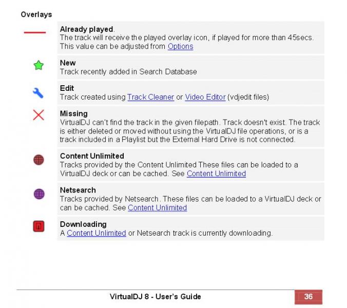

When I search for music under content unlimited, sometimes the icon has a red dot on it, and sometimes it is purple. What does this mean? (I think I have even seen songs from the same search show a different color at different times, but I am unsure.)
Forgive me if the answer has already been posted, I have been unable to find it. This page seems to be a little outdated: https://virtualdj.com/wiki/Browser%20Disc%20Icons.html

page 36 of the user guide might have what you need

Thank you, that helps. I think my confusion comes from the other day when I was searching for a lot of songs. At first, everything I searched for had the red icons. Then at some point, it seemed like the searches only returned results with the purple icon. Because I was confused, I searched again for some of the earlier titles that had given me red-icon results and I was only getting purple icons for those too.
I guess unless I can replicate what happened, I'll just have to assume I did something weird. Thanks for the help!

they were red during downloading after that they will be red no more :-)

Help.. Red and purple thing.... Anyone got any ideads how to fix this.??
When i search Content Unlimited and the results come back with a red dot.... everything works fine....
But then i do a search and the purple dot comes up, most of the time it wont let me play or download it...

Did you even read the second post of this thread, you know the one with the explanation and icons????. The red dots are from a service you pay for called content unlimited. The purple dots come from the world wide web called netsearch, which you do not pay for, and may or may not be available, the quality can not be assured, and you can't depend on. That's why it's free, and you use at your own risk, there are no guarantees. You can read the manual, and it may offer more info on this subject.

Thanks for your help..
but its kool... iv worked out how to disable the net search..
just using my own stuff and Content Unlimited
