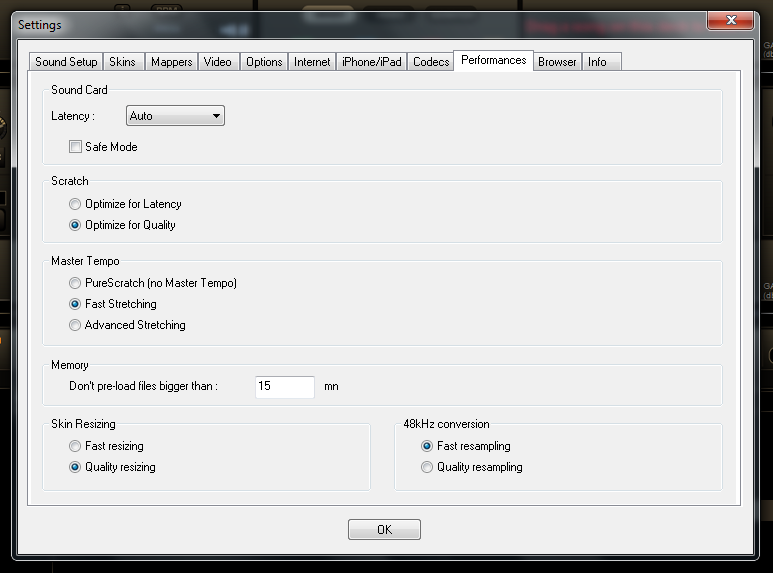

I have a Gemini G4V and when I play live, I have these settings in my Sound Setup:
Inputs: None
Outputs: Headphones
Sound card: Gemini G4V (master), built-in laptop soundcard (headphones)
Also, my Performances tab looks like this:
Anything I can do/any suggestions to make my current setup produce the best output it can? And I've been hearing how VDJ has bad audio output compared to other DJing software but I've never really noticed it myself after using it on/off for a while now. Any studies/research I can read up on either on here or somewhere else in the Web that discusses that subject?
Thanks, guys!

should be ok with these settings ( maybe skin set to fast resizing ).
but not sure why you a using a V7 ( Pro ? ) when you are a V8 Subscriber ???
Soundengine of V8 is much better than V7.....

I second that. Imo, essentially your number one setting adjustment, so to speak, is installing version 8, period.

There should be no need to use your onboard audio interface for headphones.
The G4V has its own audio interface which provides a master channel and a headphone channel.
It's far better to use the one low latency interface than to split the signal and use one low latency and one consumer.

As stated above, you should be using the audio interface from the G4V only. I am also confused about you coming out of the headphone jack to your mixer. You have outputs on the rear of this unit, XLR and RCA. These are the outputs you should use to connect to your mixer. You would get optimum sound quality, by using the full potential of this controller.

I'm confused, why would you be using the controller outside of its default setting? Stock it should come set to use the controller for monitor and for output (Headphones Channel 3&4 and Master Channel 1&2).
