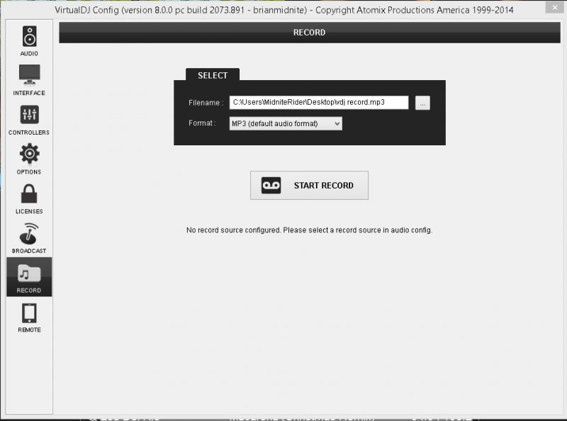

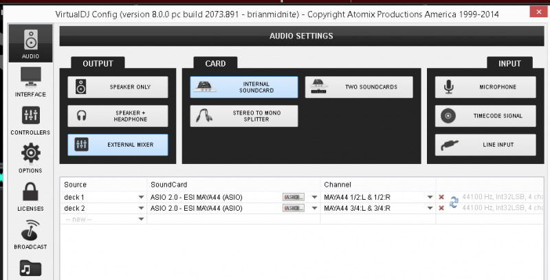

Looked in audio config in advanced settings but don't see the answer there! please point me in the direction,thanks

are you using a controller?

Audio settings

If you're sending each deck out to its own separate output (i.e. you're using an external mixer) then your "record source" is the output of that external mixer - because that's where the mixing is taking place. To record it using VDJ you'd need to send the mixer output signal back in to the computer, then select that input as a record source.
Alternatively, just record from the mixer using hardware, such as a solid state digital audio recorder (the modern answer to the tape deck).
Or.......you could mix using the internal (on screen) mixer, then the recording could be done "in the box".
geposted Tue 09 Dec 14 @ 6:15 am
You have your output configured to connect it to an external mixer - this means VDJ does not mix up your tracks any longer because you did it outside with a analogue mixer.
You need to connect 1 line output of your Soundcard to a free Line input on your Computer and select this channel to record.
Greets, Heiko
Greets, Heiko

I'm still a newbie to digital djing, I have a licence for a Pioneer XDJ-R1 and using the VDJ8 software.
I received help from the support team to get the setup giving me sound the way it needs to be ie split headphone cueing aswell as the main master speakers being independant, because under my attemps ALL sound was coming through one channel and there was no split cueing etc, but thats sorted now, i can dj with my XDJ unit as far as i am skilled to do so at the moment.
The current problem as with everyone who has already had issues in this thread is the recording function.
The mixer mode within my controller is XDJ so im not using the software on screen mixer.
on the settings within VDJ8 my output is "external mixer"
card is "Pioneer XDJ R1"
there are 4 deck sources, and i have tried to add a "record" source of which it's soundcard is the Pioneer off channel 1&2, i apply and go to the record tab to be faced with the message "no file selected" when i clich "start record" it is set to be "mp3(default audio format)"
talking briefly of my wired connections the Pioneer sends a usb connection to the rear of my pc (running windows 7) and there are 2 xlr to phono leads plugged into my two big speakers that are wall mounted. i have no seperate monitor speakers as i just cue in the headphones.
hoping someone can shed some light on this so i can get my new tunes i have to mix recorded for myself and friends to listen to via cd's burned from the recorded file.
thanks.
thanks.
geposted Sat 07 Feb 15 @ 10:42 am
