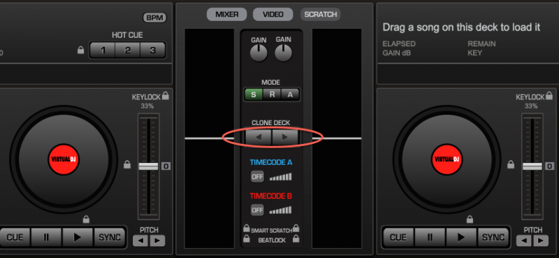

Yeah it's DOABLE using the instant double approach too.
I've seen this trick first on the manual of my TTM57 (which is gone now due to upgrade).

The EQUIVALENT of instant double in Serato is the CLONE DECK in VDJ.
You have to be in Scratch Mode.
See below...
See below...

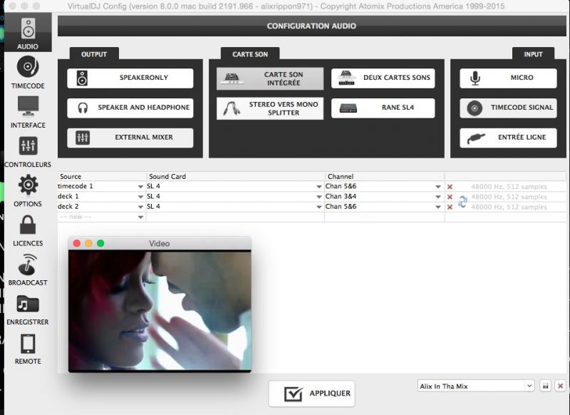

OK and how to configure the audio Setting
geposted Sun 12 Apr 15 @ 4:51 am
Finaly i have find this config for VDJ and it works well well well :-)
