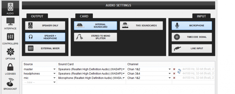

Its pretty much the same procedure as described here... https://virtualdj.com/wiki/EffectsOnMic.html
1. Add Microphone (mic) line to your audio configuration.
Example.
Example.
