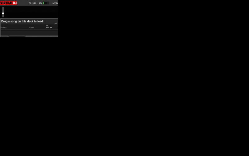

Hi Could anyone offer any advice on how to fix a display issue please. I have just installed a new graphics card into my Win 7 PC a Matrox 9148.
Now when I open VDJ I get basically a black screen apart from bits of deck 1 showing - VDJ is open but none of the other decks or controls are showing (I have a 4 deck skin as default).
Any ideas how to resolve this one please?
Many thanks

          Thanks for the reply and yep all that's been checked and the latest drivers are installed- I've also un-installed VDJ (fully) and downloaded and installed the most recent version but with no luck.
It's odd because since posting this message I've found that if I change any of the display setting's e.g. simply change what monitor is the main one or move 1 monitor to another position, click apply and VDJ appears normally but if I close VDJ down and re-open its back to how it was on the screen shot.
I've now had time to test other programs on the PC and all of these work fine - its just VDJ causing the issue.

          Wasn't possible to try that as I couldn't see any of the controls or grab an edge to re-size. I did think if I could minimise it that would be an option but every time I tried to open it, it opened maximised.

          Thanks for the replies guys,
I can't grab the corner to re-size in the normal way - I have tried that as I thought that would be a way to 'refresh' the screen.

          Just noticed that in the options & tweaks settings under skins it has a setting of 'maximised 2' & skinPosition  1399,59,1260,918 is this what you mean?
    geposted Sat 13 Jun 15 @ 4:53 am
          Changing the skin option setting's doesn't resolve it !
