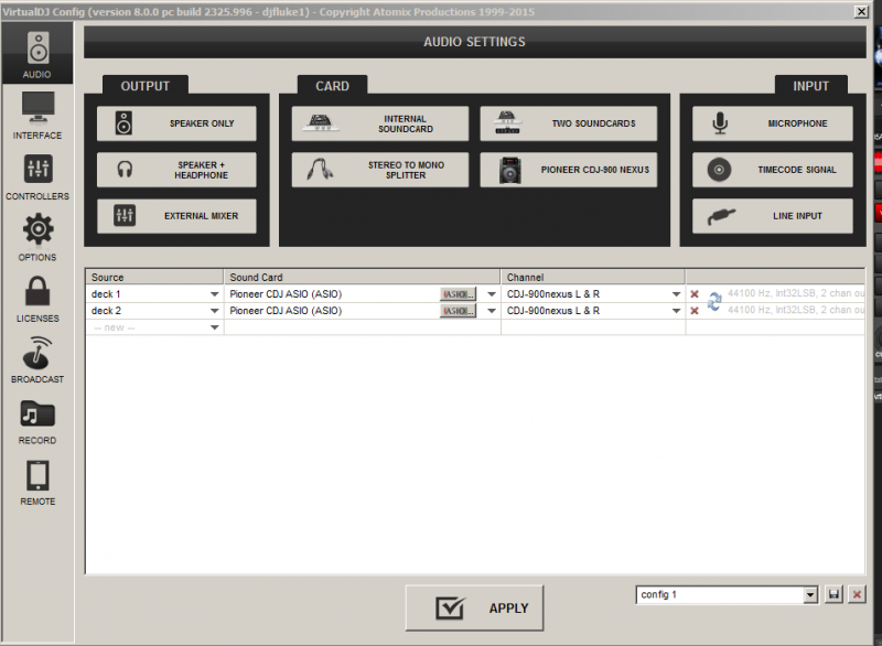

Hi,
This is how I have it setup.
Can some one just give clear instructions as to how this should be setup?
Thank you for your time.

On the right side of the image you posted there are 2 blue arrows forming something like a cycle.
This is actually an icon that will swap the audio outputs routing.
So, if sound from deck 1 comes out from deck 2, just press this icon ONCE and hit the "APPLY" button.
