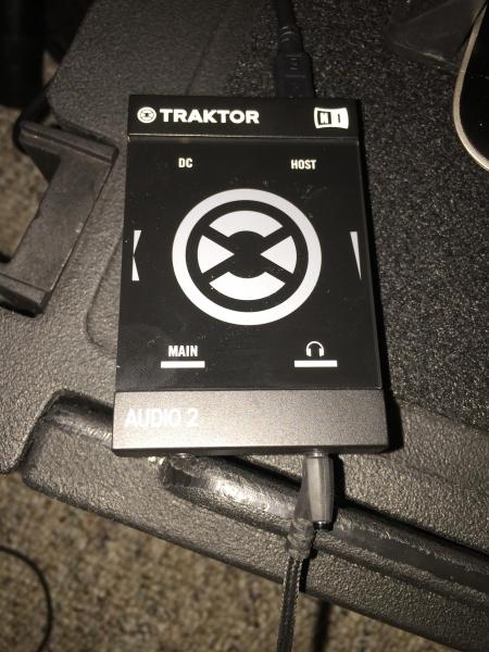

Just picked up this sound card for when I play at clubs that don't have much space so I figured this would be a good choice because its nice and small and portable.
On the previous versions of this sound card it hard 2 outputs and 1 would be the master and the other was the cue with a volume slider on each side for each channel.
On this one it looks like it has the volume slider on each side, but they both turn infinitely... the one on the right looks to have a volume up picture on the side where the one on the left seems to have a picture of two volume sliders.
What's weird is when i first hook it up I am getting the master signal out of both....then if I play with the slider on the left it seems to start working correctly where the left is the master and the right is the cue.
Does anyone else have this sound card and does it act the same way?
In the settings I am using the ASIO driver and have cue and master selected

Yes, that's normal. The "second" output is for headphones and when the device is initialized NI opted to send a 50% mix of headphones and master

Thanks...I wasn't sure if it was functioning correctly.
What's weird is the headphone jack is on the right but the slider that changes that functionality is on the left?
