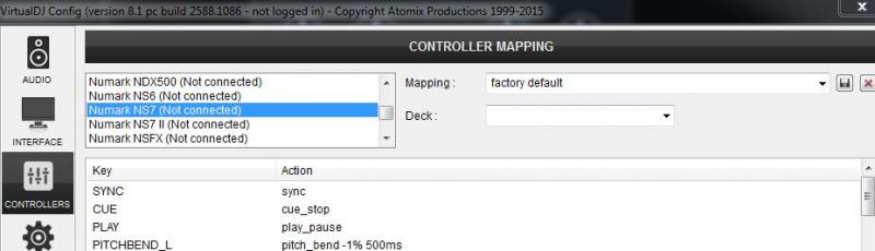

been using v7 decided to go live with 8 sat night.After about 7 min my lights on the ns7 stared going crazy i.e. blinking or just staying on but no problem with my sliders and it didn't affect the song.Still thought it was a good idea to switch back to v7 any ideas what might have caused this issue?

Try resetting your mapping in version 8 to factory default in case something has gone wrong there.

So used it last night,adjusted the latency and flawless great job vdj team
