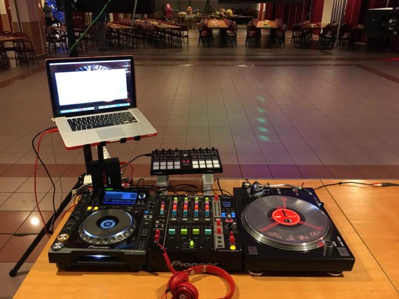

here is my config :
Here is my last night setup :
I can't find where the problem come from

Also the CDJ in your pic, is it used with timecode or as a controller ?

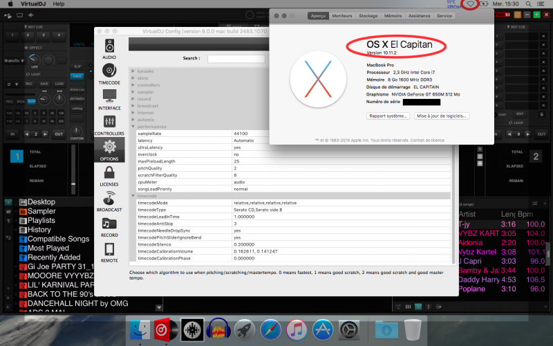

Here was my settings (if someone can tell me if the settings is good for mixing with timecode) :
How you can see the wifi Connection was turned off.

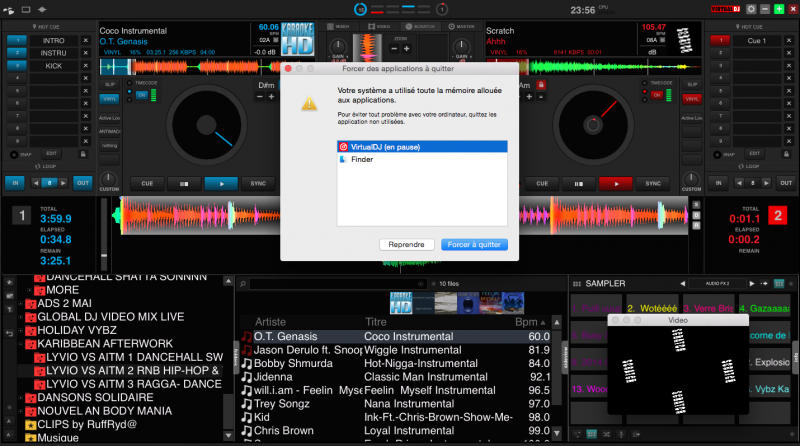

So Tonight i was training a little bit scratching on my Yosemite Session and surprise after about 20-25 mn something strange happened,
the waveform was jerky when i was using my TT. As soon i was released it was fluid. and after that VDJ stopped working :
i checked my Skin setting it was on 40 fps

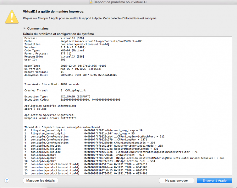

I restart the application, and after a few minutes same thing VDJ stopped :
for those who would like , I recorded in a TXT file the error report.

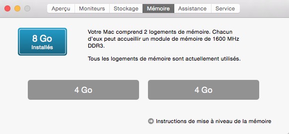

To put the odds on my side and improve the performance of my mac I will install 2x8 GB of memory and a 500GB SSD hard drive.
I cross my fingers.
