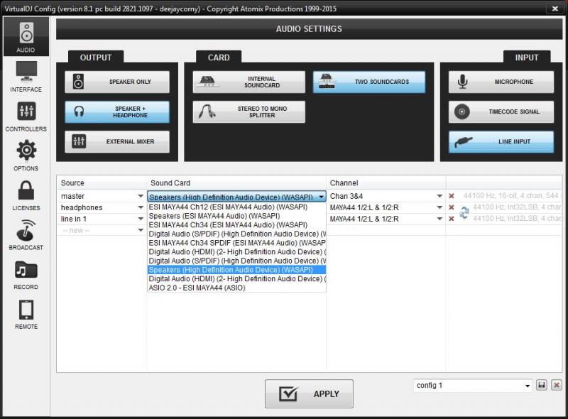

Did you try WASAPI instead of ASIO for the maya?
Also, try right-clicking the sound icon in the system tray and select 'open volume mixer' while vdj is open. See if perhaps the volume of virtualdj is down by any chance.
geposted Wed 20 Jan 16 @ 10:44 am
I tried WASAPI before, and tried it again now. No sound either. Noticed a strange thing, though: WASAPI does not pass the headphones sound (no visual level output in the ESI Maya44 software), only the master. When switching back to ASIO, both channels give visual level output (but no sound)...

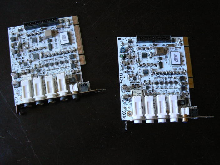

For some odd reason i never threw away the other ESI Maya44 PCI card, and I decided to try and put it in to see if it also magically worked again... and YES, it's working! So, it was never dead either. Now I have two soundcards that work, but that I don't trust (for live performances)!
So I'm thinking about buying the "M-Audio Delta 44", since it seems to be the most recommended sound card on the VDJ forums.
I'm still baffled about that no-sound problem, though. It cannot be the computer, since this is a different one then I used before, with the first Maya44 card...
