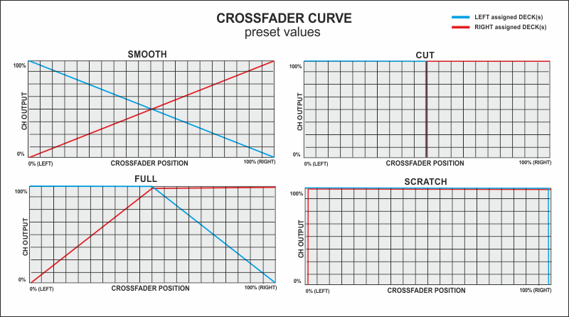

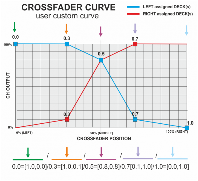

Yes of course, both tracks will be heard if the crossfader is in any other position other than the edges and Smooth or Fulll is selected.
Your best option is to draw the lines that represent best the wanted crossfader behavior and we can help you with a custom crossfader curve.
Here are the presets ...
an example of a User (Custom) crossfader curve..
The "Cut" could probably be what you are after, but a User(Custom) one may be better since you may need to have some area (e.g. from 45% to 55%) where both decks need to be heard.
