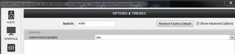

Options (advanced) earlyAccessUpdates to no

Unless you manually changed your settings to get "Early Access" builds then you should get only public builds.
Open VirtualDj config, go on preferences and search for the "earlyAccessUpdates" option. Make sure it's set to "no" and you should only get public builds.
