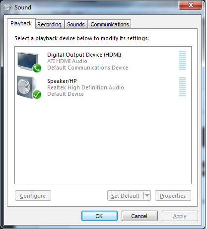

ive just been playing around with my laptop settings and have come up with this, not sure if it will help but it seems to be along the correct lines
im sure you may be able to incorporate a similar setup with your soundcard/s
this allows me to have master via hdmi
master on channel 1 of my headphones and pfl on channel 2 of my headphones. master appears to play continually via both hdmi and headphone channel 1. and monitoring will work from slelected deck into channel 2 of the headphones. with no overlay on the main output.
my cards in windows are setup as such. (both cards are internal)
geposted Sun 28 Feb 16 @ 6:20 pm
