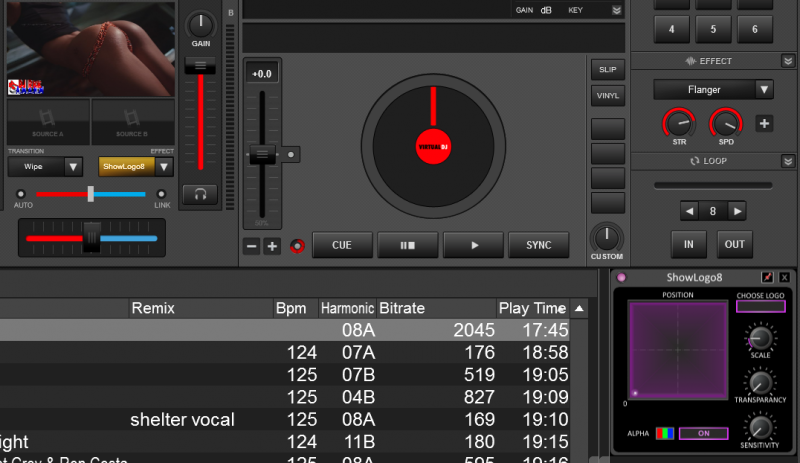

Not only is it very simple to remove the VDJ logo, but it is equally simple to add your own. There is a ShowLogo8 effect located in video effects, or available in the download section. Select the gear icon next to it, and it will open the(GUI), located to the right. There you can add your logo as a PNG, position it, scale it, and have it as transparent as you like.
