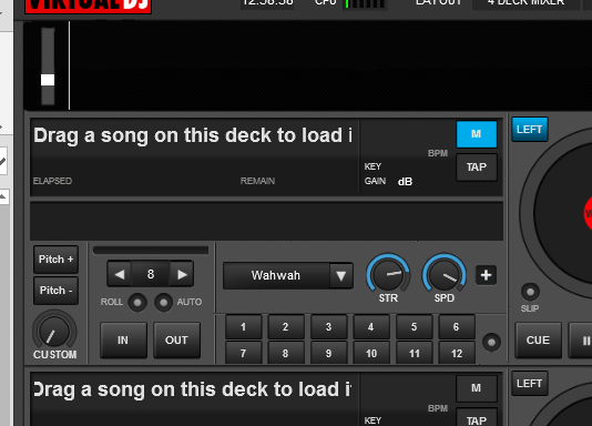

I have come up with a sort of fix which helps me though by editing the skin xml and moving the original buttons up a bit and adding in an extra 6 on each deck as per the pic
This works fine but I'm still limited to 12 POI's per deck which whilst not exactly what I wanted is better than I had.
