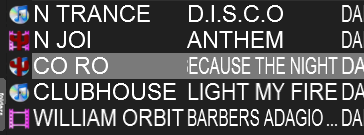

Hey Phil, would you want something like this as an indicator...
or something like this...
or do you have an icon you want to use.
geposted Fri 15 Apr 16 @ 4:11 pm
Here's how the other one looks for a comparison..
geposted Fri 15 Apr 16 @ 5:08 pm

Hiya mate the top one would be ideal. As a matter of interest, what does the green star in the top right hand corner of the icon mean?

The green star means newly added. It last for a couple of days after you add a track to the software.
