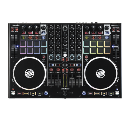

Reload Terminal Mix 8
$700 via Amazon (http://amzn.to/1UhQztd)

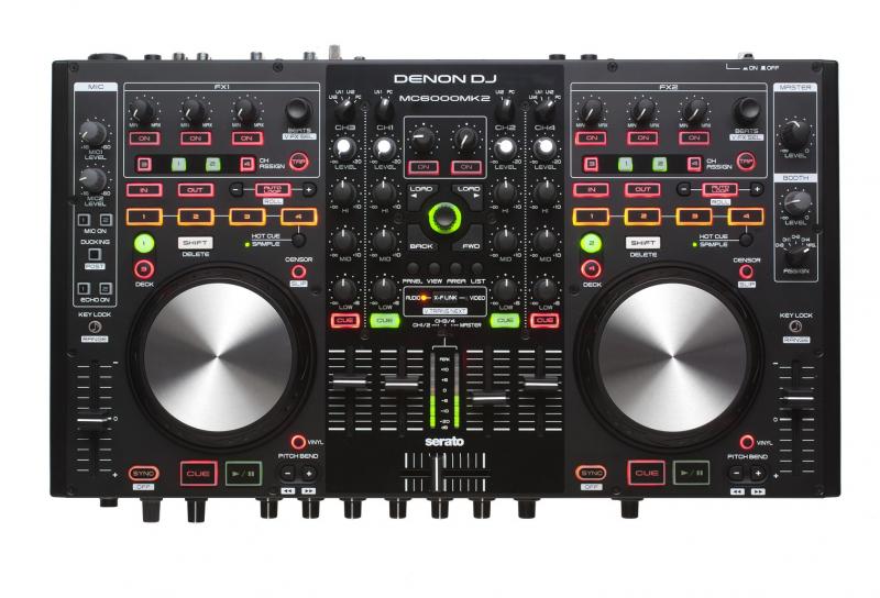

Denon MC6000MK2
$700 via Amazon (http://amzn.to/1N0y1vY)

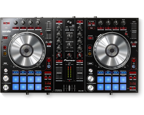

Pioneer DDJ SR
$600 via Amazon (http://amzn.to/1YUpF9W)

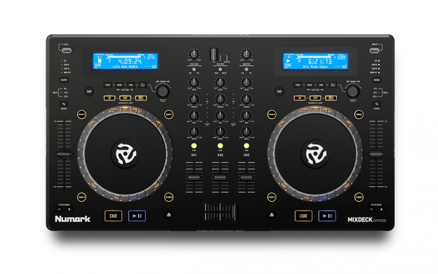

Numark Mixdeck Express (2016)
$500 via Amazon (http://amzn.to/1XWoqqy)

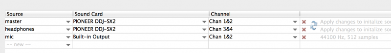

Played with the SX-2 with mic with the controller & it work with VDj-8.I mapp the knob to see it move with my mixer sider.
