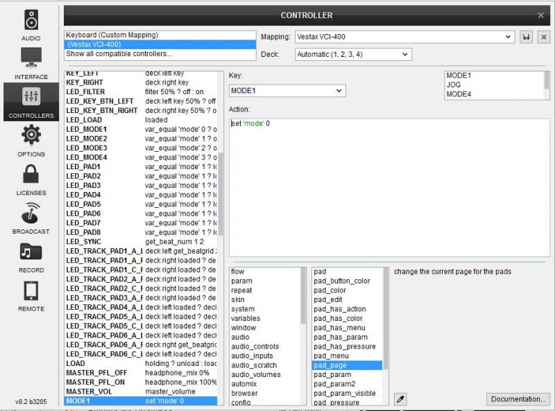

I want to program the banks in 8.2 to switch views when i switch modes.

well its the vci400, the 4 mode buttons under the 8 sample pads, they are set to 4 modes...Mode 1 - cues, Mode 2 - Loops, Mode 3 - sampler, Mode 4 - Freeze/Slicer
I been messing around with it I was able to create the freeze/slicer label in the options but i havent made any scripts.

I set up the pads on screen, I just need the screen to switch modes when i switch modes on my controller and other mixer but once i learn to do it on the controller i will do it on the mixer also

In order to change the pad page you see on your screen you just need to use this action:
pad_page 'hotcues' or pad_page 'saved loops' or pad_page 'MyOwnCustomPage' e.t.c.

So how would i add it in front or after the setting its not working for me

never mind i have it thank you......
