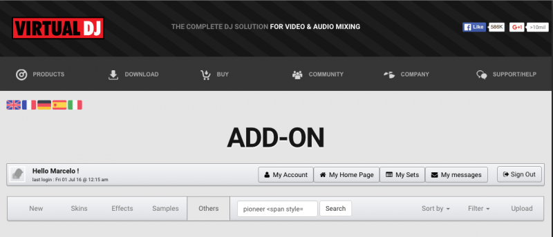

my not turn on the lights of channels, not light play / cue, does not the light from the center of the jog, hotcue lights do not work, my license is Pro and this link above leads me to the virtual screen but nothing happens ...
