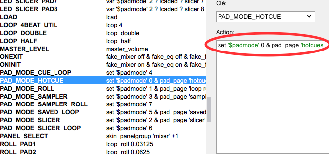

Hi everybody
i have started to find a solution, but there is a mistake, i have put the script like on the picture.
but it works only on the left Deck. How can i do to have the display on both decks or depending on which deck is the active Deck ?

you need something like ..
... & deck left pad_page 'hotcues' & deck right pad_page 'hotcues'

Thx Dad
I've tried this and it works only on the right deck now

Also you will have to change the mapping on all PAD buttons with the new "pad" action
So:
ROLL_PAD1 button that on your mapper now is mapped as "loop_roll 0.03125" needs to be remapped as "pad 1"
The LED of the same button (LED_ROLL_PAD1) needs to be remapped as well to "pad_button_color 1"
On the same manner SHIFT_ROLL_PAD1 needs to be remapped to "padshift 1" and finally
LED_SHIFT_ROLL_PAD1 needs to be remapped to "pad_button_color 1"
As I said you'll have to remap ALL XXX_PADX buttons and leds. Otherwise even if you change the pad pages the buttons will still perform their assigned actions and not what you see on the pad page.
So:
