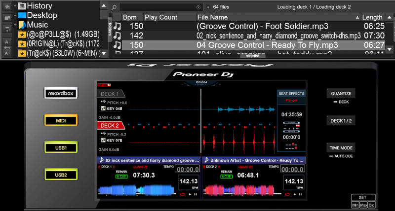

That's not a browser - that's 3.5 lines! Plus all your left side icons are squashed together because the browser is so small.
Why waste so much screen space on displaying a "looky-likey" picture of a Pioneer display? You could use all that space for a full screen browser.
The track info should be displayed on your "deck" tablets - or your main computer, seeing as you still need one to run all those remotes.
Just doesn't make sense to me. :-/

thats used as a display and i had to load it on my laptop monitor to take a screen shot to show you it dose not load the browser the same way on a tablet watch the video link i posted before putting me down please :P
https://www.youtube.com/watch?v=uOnkWSL_fEE
not only that do you think if i created the sklin i use for the browser that i would be asking for help from you guys with a skin for a mixer ??
hahaha !! :))
