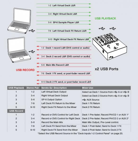

Yeah okay, TTM57mk2 definately supports effects return over USB. I can even choose the effects return channel in the soundcard menu, just can't choose effects as its source. Here is the channel layout for my mixer if it helps

Rane 62, 64, TTM57MKII and Pioneer DJM-S9 are the ones that we know for sure that they offer FX Send/Return Channels. We' ll check others too when this is implemented.
