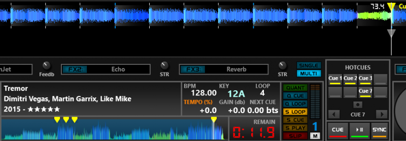

Cue 7 with suggested script:
Cue 7 with your script:
If cue 7 is not where you want it to be on suggested script let us know how you want it so that we can improve the script.
PS: I have the impression that initially you asked for 16 beats before the end, not 32. Therefore we should compare cue 8 of your script with cue 7 of suggested script

Ok this script only makes 3 hot cues (1,2 &7) and 7 is usually at the very end of the track. I'll post screen shots and a video of it tonight.

Without colors, and with cue 7 exactly ON grid 16 beats before the track ends (for use on custom buttons):
With colors, with cue 8 exactly ON grid 16 beats before the track ends and cue 7 32 beats before the track ends (for use on custom buttons):
set_firstbeat & set_cue 1 & goto 16 & set_cue 2 & goto 32 & set_cue 3 & delete_cue 7 & goto 100% & get_beatpos & param_cast 'int_trunc' & param_add -16 & goto & hot_cue 7 & deck 1 goto_cue 1
set_firstbeat & set_cue 1 & cue_color 1 'white' & goto 16 & set_cue 2 & cue_color 2 'yellow' & goto 32 & set_cue 3 & cue_color 3 'green' & delete_cue 8 & delete_cue 7 & goto 100% & get_beatpos & param_cast 'int_trunc' & param_add -32 & goto & hot_cue 7 & cue_color 7 'orange' & goto 100% & get_beatpos & param_cast 'int_trunc' & param_add -16 & goto & hot_cue 8 & cue_color 8 'red' & goto_cue 1
Selected as best answer geposted Thu 02 Feb 17 @ 2:19 pm

PS: Try the new code. It doesn't try to calculate phrases. It just goes 16 and 32 beats before the end and snaps to the grid.
The script before was trying to snap on a primary beat as well but it seems that's not what you want
