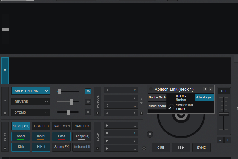

Is there any plan soon to update the ableton link feature? At least to make it follow the master tempo, since when it is enabled in the master effect section it only follows deck 1. Thanks :)

Unfortunately, when the plugin is active in the master effect section, it only follows the Deck1, so if you switch to deck 2 and play a song and try to change the bpm my iMaschine app will not follow deck 2 even if it is the master deck. The Ableton link should follow the Master bpm, and Master bpm should mean that read from the master deck.
This is the description of ableton link plugin from Ableton site: Hop on to the same network and jam with others using multiple devices running Link-enabled software. While others play, anyone can start and stop their part; or start and stop multiple Link-running applications at the same time. And anyone can adjust the tempo and the rest will follow
but sadly it is not the case with VirtualDJ. Or maybe I am doing something wrong.
I am using VirtualDJ with iMaschine2 app on my Ipad, so I am trying so link the app with the master tempo of VDJ and vise versa. Thank you

Update now it works better when I switched off the Link plugin in master effect section, and only switch it on for deck 1 & deck 2, now I can change bpm on whatever place and all is syncing together,
but first when the master ableton link is ON in addition to Deck 1 link and deck 2, the bpm is stuck on a fixed value that I couldn't change on vdj, only in iMachine 2 app.
So now it works better.

The plugin doesn't seem to work reliably. Sometimes it doesn't sync up with another app, when that app was running first. While it does if the other app is started later, or restarted. Sometimes it's even required to restart Virtual DJ before it will sync again.
And the issue in this isn't the other app, as it works fine with other ableton enabled DJ software, such as Serato. Both when starting it before, and after.

I haven't experienced that. Connections can be lost, of course
But VDJ always shows how many other Ableton Live instances it's connected to, so it's easy to see

how to map it with my MIDI controller the nudge button so can match faster and easy,
can any one help
and its not work as instant its have to start and restart few time then its work
