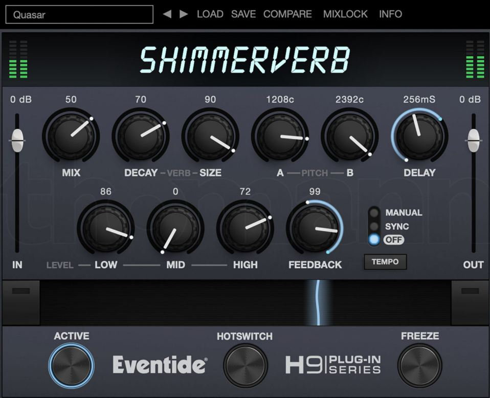

Can you not just find a vst fx that has an input and output fader on the gui and use that to do exactly what you want?
geposted Mon 08 Dec 25 @ 12:33 pm
This has one
