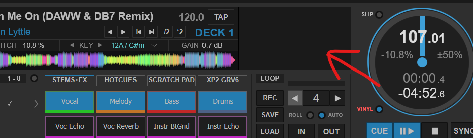

hi team
i need to know what is this area for and how to get rid of it and make the wave at full
thx all
thx all
geposted Tue 07 Apr 26 @ 6:36 am
This is the deck video screen. Change the mixer section to mixer, scratch or master to hides this little screens.
geposted Tue 07 Apr 26 @ 9:10 am
thx a lot dennyo

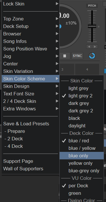

deejay_willy wrote :
hi all
Has anybody found a way to change the deck colors ...
...Any help will be appreciated.
You can set all Decks blue, yellow and blue-gray at the skin button.
Red is not include. You can edit the xml.
The colordefine are at the start of xml.
Search one of this:
<!-- -------------------color-define-not-daylight-blue-red------------------ -->
<!-- -----------------color-define-not-daylight-blue-yellow----------------- -->
<!-- ----------------color-define-not-daylight-greyblue-only---------------- -->
best way, search this:
At the next 327 rows you change the color of Deck 1,2,4 to the color of Deck 4
for example:
original
<define color="textcoloron" value="#3E9FD7" deck="1"/>
<define color="textcoloron" value="#EA414C" deck="4"/>
<define color="textcoloron" value="#27C16A" deck="3"/>
<define color="textcoloron" value="#FFBD52" deck="2"/>
edit
<define color="textcoloron" value="#EA414C" deck="1"/>
<define color="textcoloron" value="#EA414C" deck="3"/>
<define color="textcoloron" value="#EA414C" deck="2"/>
for daylight do the same at:
<!-- ---------------------color-define-day-blue-yellow---------------------- -->
geposted Tue 07 Apr 26 @ 8:35 pm
