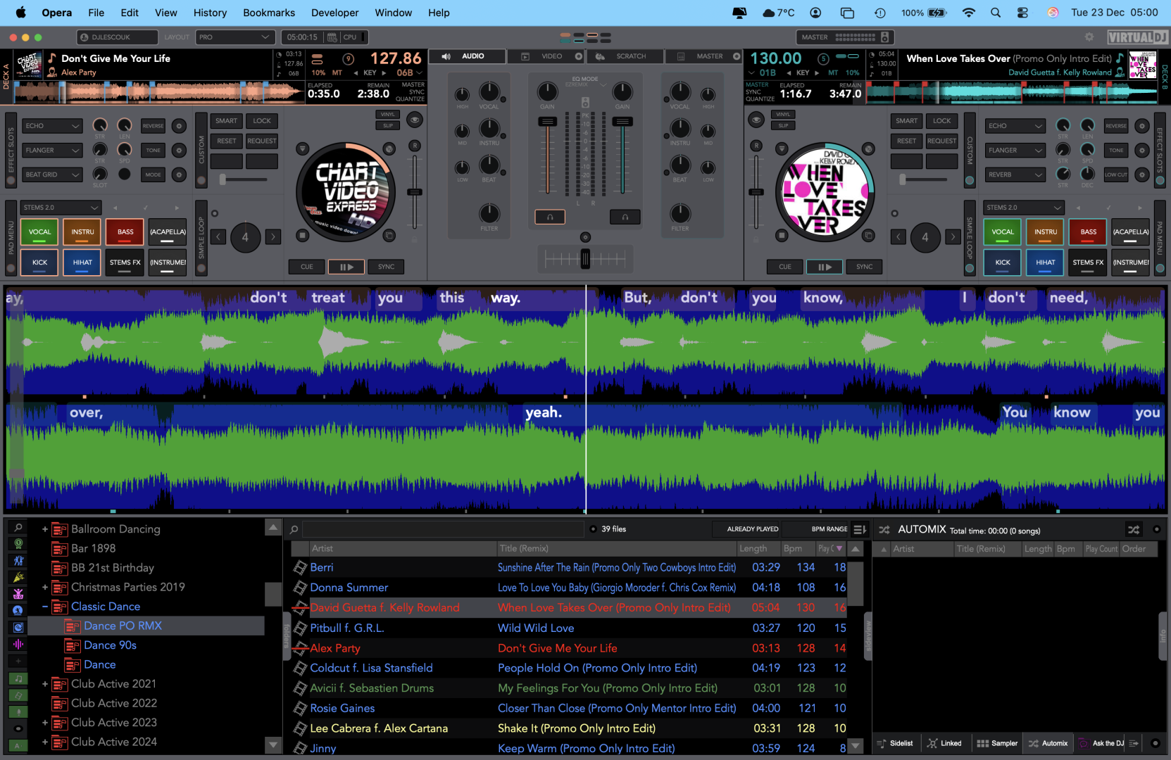

Both Project X and Project X Slider work fine here (14" MBP)
Main System - Apple Silicon M1 MacBook Pro (14-inch, 2021), 16gb, 500 gb SSD, macOS Tahoe 26.2, External Crucial 2tb X9 Pro SSD formatted APFS containing Music & Video databases. VirtualDJ v2026-m b8978 AI
Main Controller Denon MC7000.
geposted Tue 23 Dec 25 @ 5:05 am
