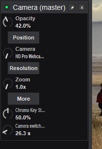

I want to map the webcam controls to my device but cannot find the correct variable I have been trying video_fx_slider 1 and assigning to a slider on my midi device, any assistance is appreciated.

As this thread is active, I'd like to ask if there's a way to resize the video window via knobs/faders on the skin or a controller, rather than needing to open the camera settings, click the 'position' button then drag the little grey box around with the mouse?
Also is it possible to save preset sizes, so they can selected from a button/menu/script?

Currently there is no resize parameter for camera.. .
And the position element opens a new window, so while in theory it could accept some effect string perhaps, I dont think you can send anything to this button as is now. . buttons are just on/off (click) as default
