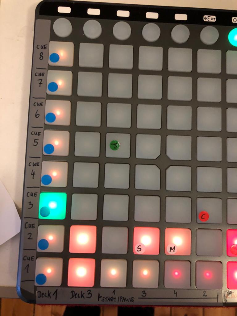

Thanks Rune, but that would be too easy.
There are 8 Lights in a row connected to 8 cuepoints.
During playback whenever one of these 8 different cuepoints is reached,
the special LED shall make the traffic-light effect.
To see, WHICH point is coming up.
But with my script only the last selected pad shows the traffics...
On the picture:
cue 3 was selected by pressing pad 3
the song is started at cue 3
Now pad 3 lights red, yellow & green, even if cue6 or cue7 is coming up.
(maybe because of the [deck left cue_select 3 ?] in my script?)
But it´s necessary that pad 6 shows the colors, when cue 6 is almost reached.
And Pad 7 for cue 7...
