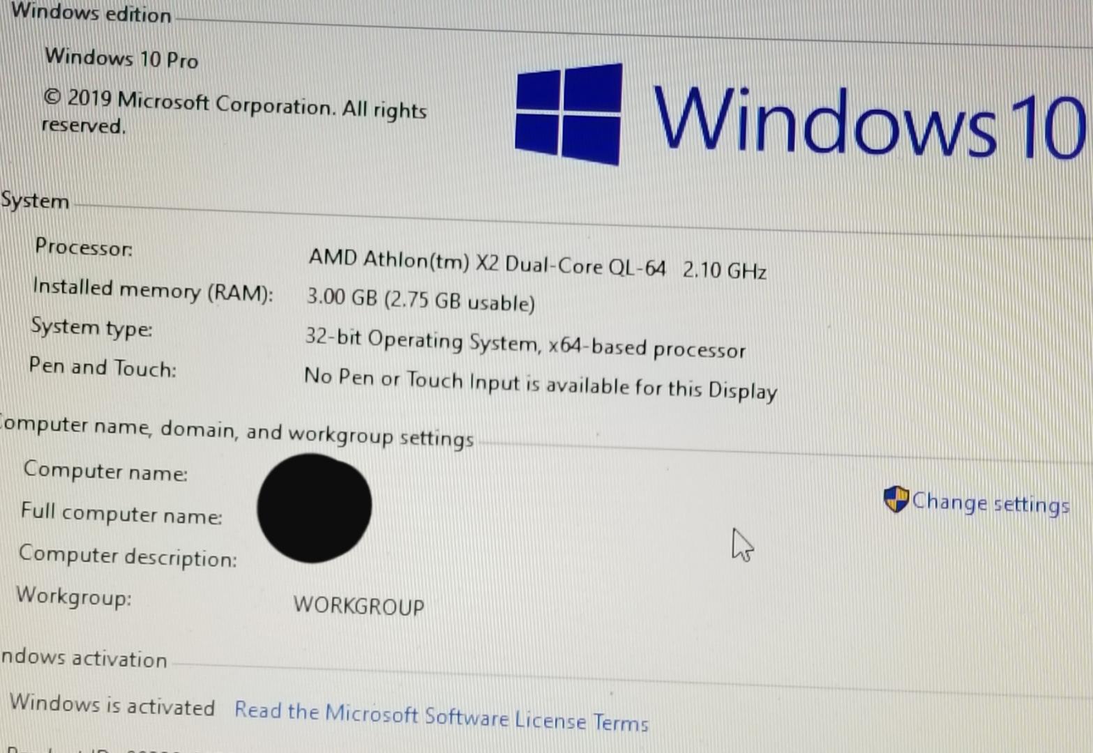

i have this kind of laptop and i use him only for DJing

It's a 2009 processor, 32 bit windows and very little RAM.
It's probably struggling to decode 2 HD videos at the same time.

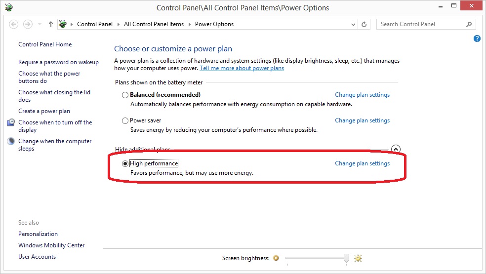

Then set to max performance and disable power saving in the intel control panel
You can also set the power management in windows to max performance, might help a little...
You do that in power options at Windows control panel
