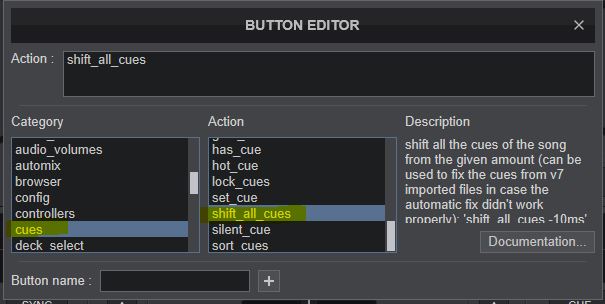

shift_all_cues ..
Search is not indexed like Google, so it searches what you input, without wildcards or &
But much better to use the editor itself in the software, and either write something you think it is, with automatic suggestions, or look at the categories. The one you wanted, is right there under "cues" :)
Alternatively you can see same here: https://virtualdj.com/wiki/VDJscript.html
And its a forum, perfectly fine to ask as well ;-) thats what the forum is for...
