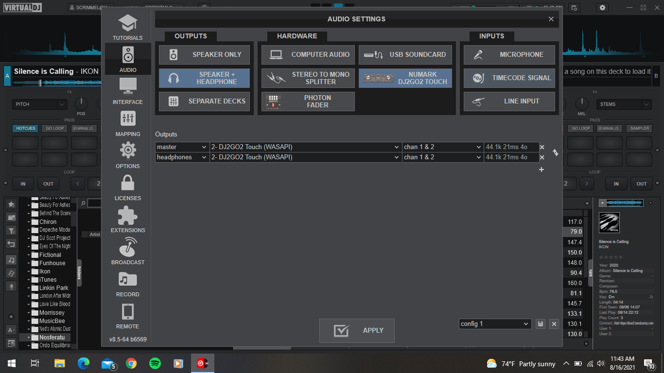

Here's the audio setup.
.png)

but that wasn't your audio setup at the time was it?
even the dj2go touch setup looks incorrect

Yes, I recreated my setup at home.
geposted Tue 17 Aug 21 @ 12:26 pm
You mentioned in the first post you used the Behringer UCA222, but your screenshot only includes a DJ2GO2, so it doesn't look like your screenshot is the same as the setup you used at the club.
Yes, it does not show up in the audio settings for some reason, but still does what it's supposed to.
