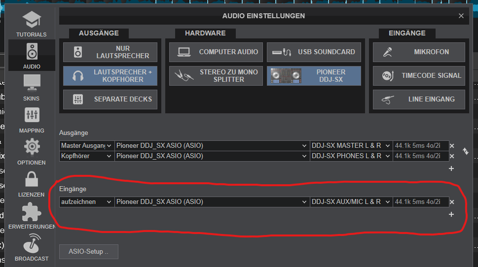

Hi,
deactivate the record input in the VirtualDJ audio config.
I had the same problems.
When the record input is on. Virtual Dj records the signal double.

DennYo Beats wrote :
Hi,
When you took off the record, what setting did you use?
