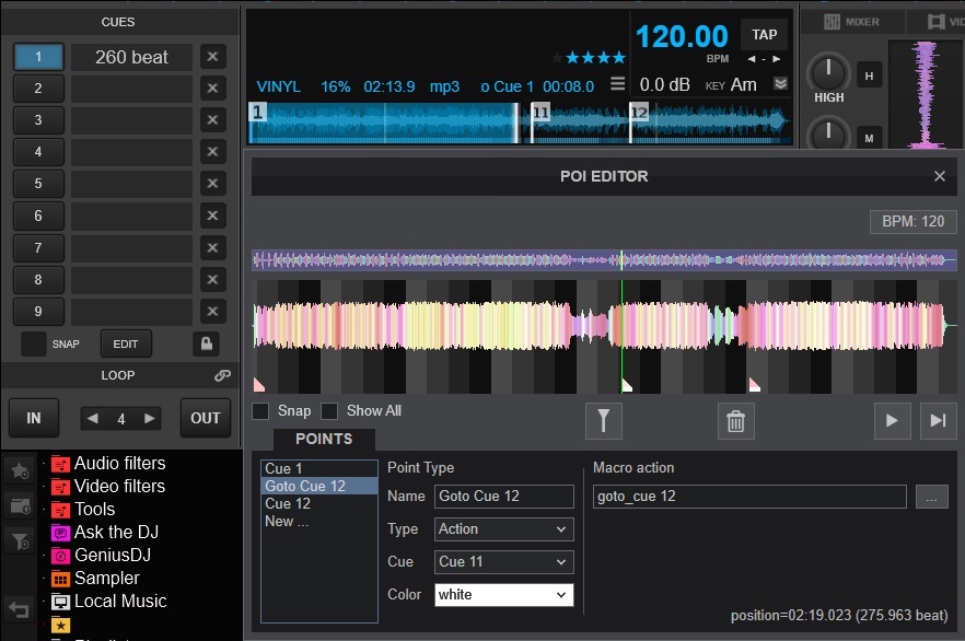

I would like to give you my explanation on "how I do this" when editing fixed jumps.
As I mostly use Fruits skin (not much different than default skin) I have 9 cue points visible and is using a cue from 11 and above to set fixed jumps (cues).
I set the first cue/jump in a file with the number 11 with the Action "goto cue 12" and then set the cue 12 as an original hot cue.
I use different color like white to make them more visible as jumps and naming the cue 11 mostly to Jump to Cue 12 etc.
If I need more jumps in a song I will go on with cues 13-14, 15-16 etc..
geposted Thu 29 Dec 22 @ 7:02 pm
