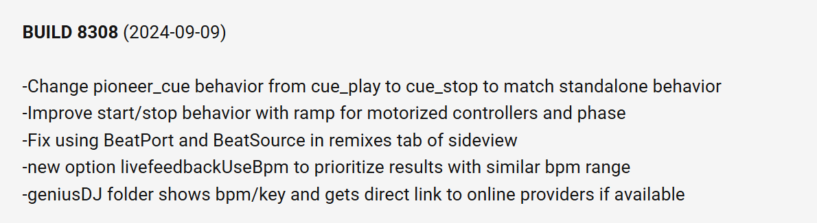

Was last September so not the latest version.
